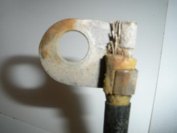

Here are some pics of the flat terminal, loop type off my obviously post war french harness.
You need a special roll crimper die to get a nice tight crimp. The second photo seems to be a generic guage terminal... its on an 16 gauge wire, but it looks like it could fit over a much larger wire.

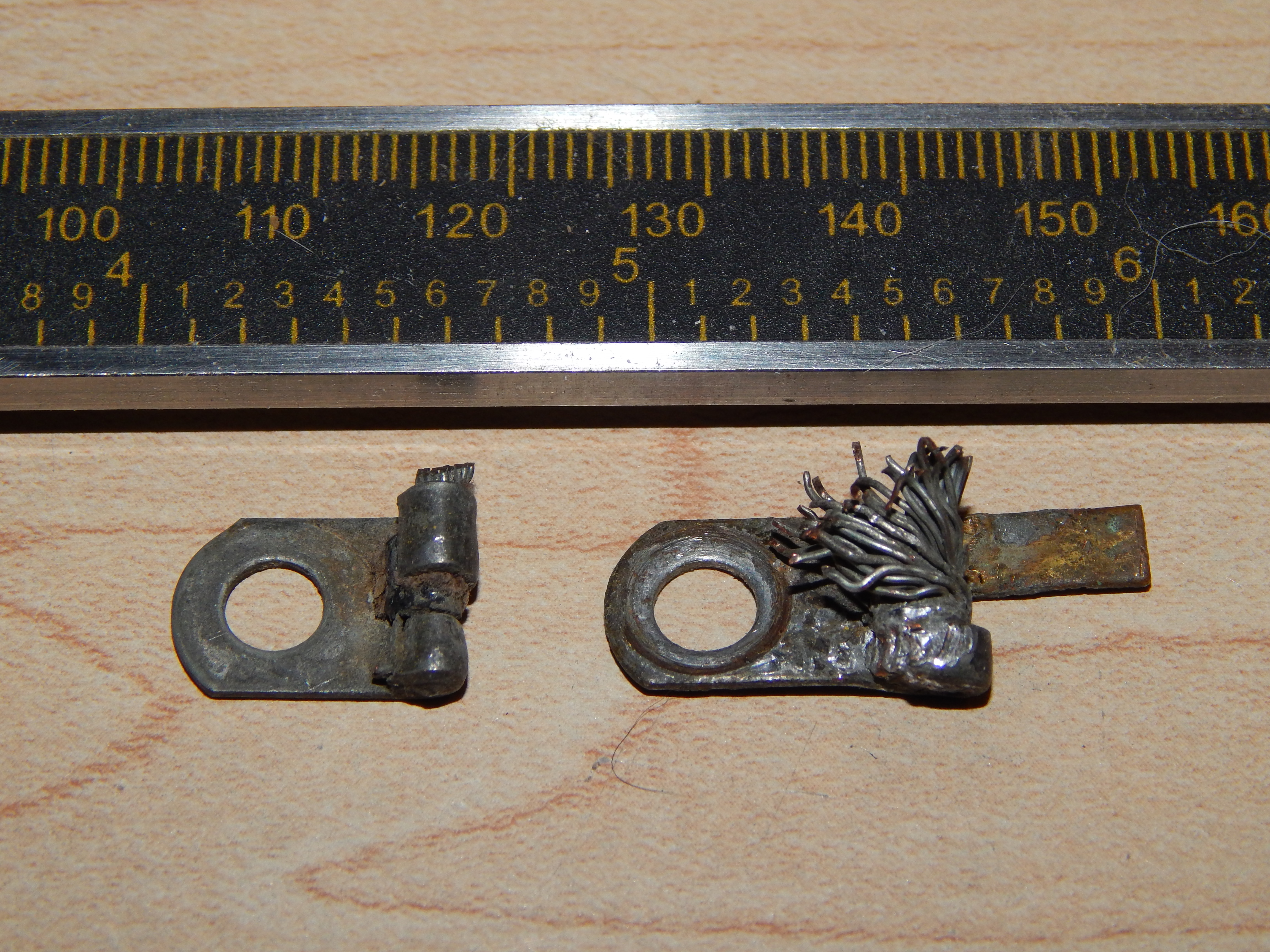

What is your opinion of these?

Not factory correct as seen on the G506/G508. They could have been supply issue, but not from GMC/Chevvy.
Here's what I see from my factory orifinals:
I believe the originals are tin plated brass. I have not seen any pure brass connectors.
Both legs are 'thick'. Factory parts have 1 thin 'leg' for the actual inner wire to be soldered to, and a 'fat' leg to hold the wire where the insulation is not cut.
Here's a drawing that even shows the legs on all the flag connectors being different sizes (TM9-801 pg 257)
Some Original flag terminals that show the leg sizes and general construction.

Thanks for the pics. So those look different than the ones you previously posted... including the rounded shape of the flag, and also the width of the crimped strips.
I bought a few any way, just in case I need to add a conductor to my harness or make repairs. They were cheap enough...
Simple enough to tin brass if I need to. How is your flag terminal project coming?
