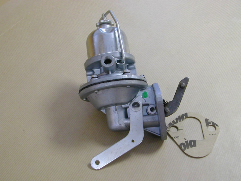

This site appears to have some good parts:
http://www.jeepest.com/index.php?page=s ... =2&lang=en
But buyer BEWARE!!!! They are passing this pump off as a GM1537714!!!!! 5 seconds to spot the errors!
DING DING DING
The primer arm is on the wrong side!!! You are gonna be hitting the oil return line!!!!
Also, the bail on the pulsator is wrong. CCKW fuel pumps mount the bail perpendicular to the engine... check your SNLs!!!
BAD VENDOR! BAD! :roll: :roll: :lol: :lol:

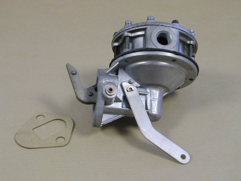

But they do have nice 6 valvers
They DO sell the more uncommon 6 valve pump:
Looks OK to me but I have no first hand experience with the 6 valves (they are late 45+ war SN 523570 and on)

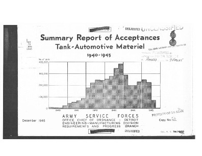

Well.... this is just guessing...best to use actual facts and figures.
It is difficult to give totals on "CCKW" as there were so many different trucks assembled at the same time. These are usually listed separate in the OCD-D statistical sheets and it is necessary to compile them to determine total production figures.
Example: deliveries for April 1945:
4.954 cargo wo/w LWB airborne,
4,015 cargo w/w LWB airborne,
268 cargo w/w SWB,
321 cargo 17" body LWB,
75 chassis LWB wo/w,
834 chassis w/w LWB ,
1,772 dump LWB w/w airborne,
27 tank gas 759 gal,
0 tank water 750 gal
= 12,226 units. (this does not include specialized vehicles)
Now this is near the 12,000 figure but some months it was over (as this is) and some it was not. This skews the figures if you are trying to determine a MFG. date.
It should be noted that all production was ended in August 1945.
