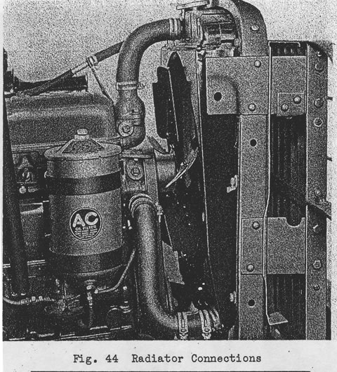

Here is what I am calling the 'Early' decal:
Here is what I am calling the 'Late' decal:
Here is what most places are selling. I call this the civvy decal. This is a 2in diameter decal.
Note that:
The Early decal is round, is just the AC logo and part number.
The Late decal is oval, contains a smaller AC logo, clearly states "Use Senior Element" and part number.
The civvy decal is just the logo.
My educated guess is that the logo changed in early mid 43. This would coincide with the CCKW becoming standardized to use common military parts, not vendor specific parts.

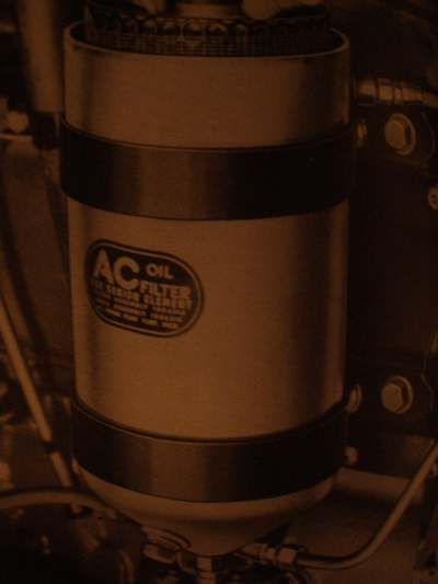

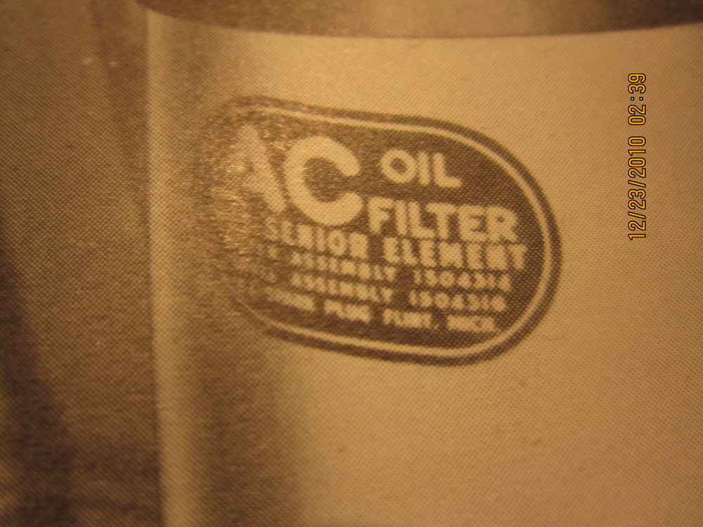

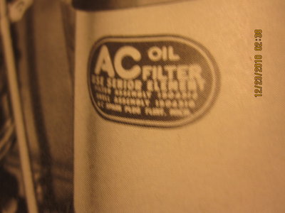

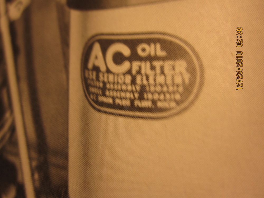

The FULL TEXT of the AC filter decal:
AC OIL Filter
USE SENIOR ELEMENT
Filter Assembly 1504314
Shell Assembly 1504316
A.C. Spark Plug Flint. Mich.
Here some pics. I had to use MACRO and ISO 80 at full 12Mpixel resolution. The original file size is HUGE and cannot be posted in the forum.
The images below are scaled to 25% original size and are JPEGs. JPEG is a lossy compression so the images get blurry. You should be able to make them out.
No such luck on the lid decal.. there simply isn't enough there to make it readable.

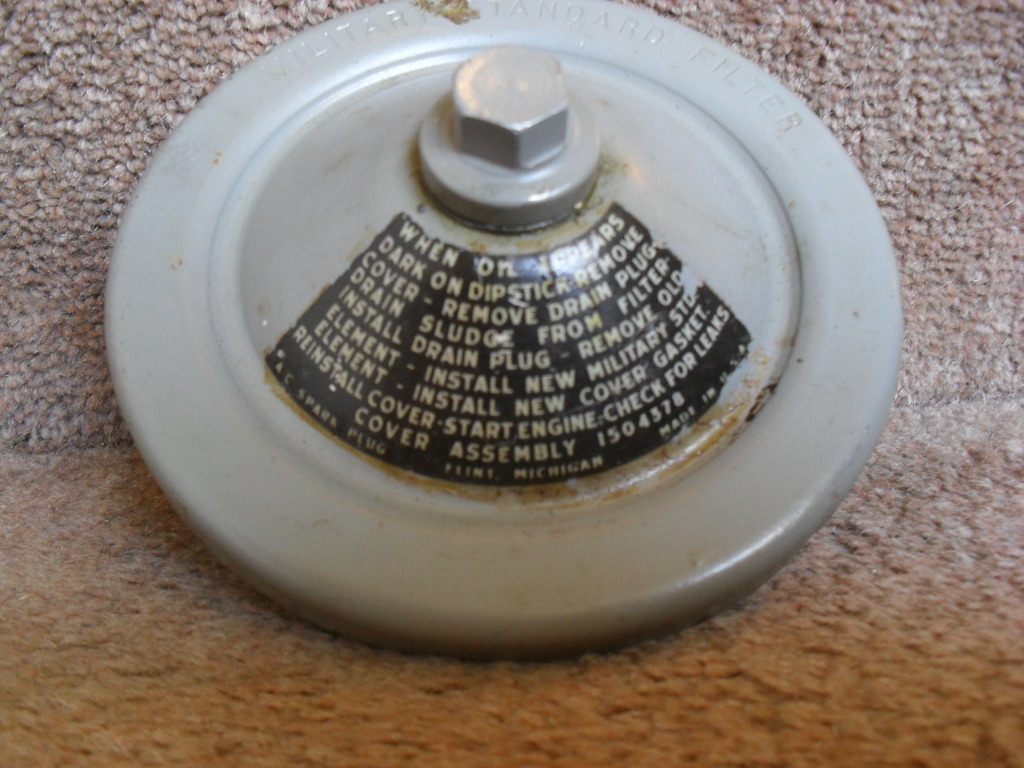

PROGRESS!!
I have been in contact with a gentleman and he has provided me with pictures of the lid decal!
Here's one of them:
Now that I have the text I can begin to have them made.
Some interesting things have been discovered:
The lid decal appears to be one color, black, and the letters are gray from the oil filter paint. I am seeking to confirm this.

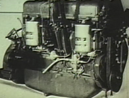

There actually appears to be an even EARLIER, early version. The very early CCKWs had dual oil filters, the decals on them are large squares. I do not have a very clear image of them, but they appear to be similar to later oil breather decal: A black line at the top and bottom, the AC logo the upper left and right corners, the copyright info along the bottom.
Lots of interesting bits in this image. The oil filter mounting is completely different, yet it *appears* as thought the lid still has the 'crescent' decal with filter change info.
The fuel pump pulsator bowl is glass, and both the front and rear bolts of the fuel pump are oil return lines. The distributor is vacuum advance and the engine steam tube routes directly to the radiator. Neat stuff.
I doubt that there are that many very early CCKW engines running about to be concerned about these decals, but if someone has a better image, please post/pm a copy.

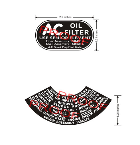

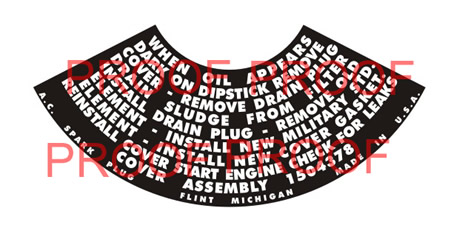

Here is the final proof artwork for the lid decal. I think its spot on.
The oil filter body is next.

I got to wondering how you determined the proper shape of the decal. Since the oil filter lid is a very short cone, did you do some flat pattern layout to determine the shape, or did you trace an existing?? Sorry to hear about the challenges with having them printed!
Re: CCKW Oil Filter decals Early/Late/Civilian
Getting the shape of the lid decal was easy.. I simply measured the two radius's of the lid and then the length was determined by using a measuring feature in Autocad. Knowing the dimensions of the lid allowed some intelligent interpretation.
It lays flat without any modification to the measured dimensions.
