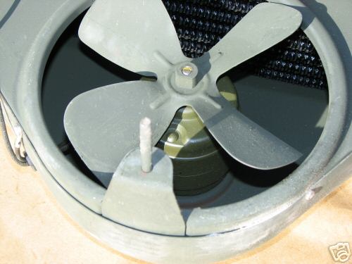

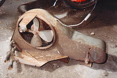

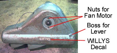

You mean something like this one??
Re: Harrison Heater
Wow you're good. It looks like that's the reason for the boss.

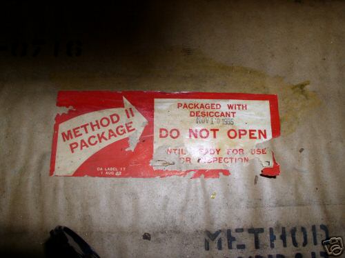

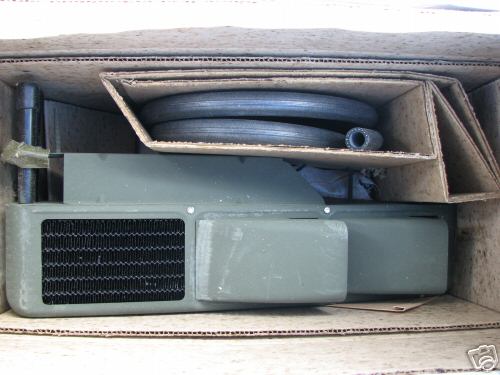

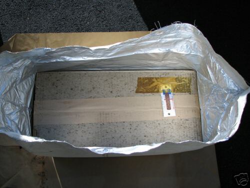

Here are some additional photos of a NOS (out of the box) Harrison heater... I did ask for a frontal shot, but you can clearly see the items that were already pointed out:
Small lower bracket with not stamped rib, straight pipes, mounting bolt is near the edge, not in the middle of the thinner section.
It also looks like the metal is parkerized... the fan motor is OD, but the rest of the steel looks like zinc park.
Re: Harrison Heater
pfarber wrote: It also looks like the metal is parkerized... the fan motor is OD, but the rest of the steel looks like zinc park.
Actually it's two different colors of OD. The fan motor is slightly lighter and also has a slightly higher amount of gloss (or less drab, depending on how you look at it).
