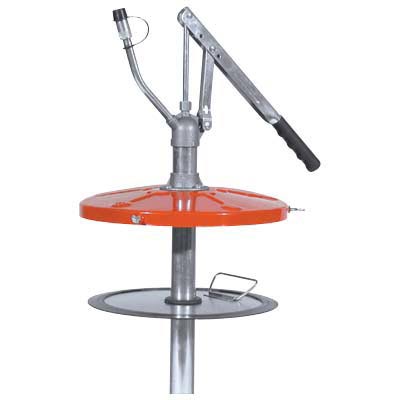

I just ordered this:
grease pump.jpg (10.32 KiB) Viewed 7725 times
Zee Line Grease Filler Pump, Model# 328
Item# 109020
http://www.northerntool.com/
I can't post a link to the item.... its session based and gives an error.
Cost to the front door was $52. The math:
A 5 gallon pail of CG-LB NGLI #2 grease is about $100 from NAPA.
Figure a 14oz tube is $5
35lbs * 16oz/lb = 560oz / 14oz/tube = 40 tubes * $5 per tube = $200
So for $152 I am getting $200 worth of grease. ($152 because grease + pump vs 40 tubes of grease)
Next pail I should save even more.

Got the grease pump! Assembled it and filled my pistol grip grease gun.. man was that EASY!!!
The only downside was that my grease gun doesn't have a separate air bleed port. It only has a single 1/4in FPT hole and I had to put the fill adapter in that.. so I can only fill it about 2/3rd of the way... I plan to drill /tap another hole in the head for an air vent. Once I use up the grease in it that in it now I'll tap the hole and do a video on the refill pump.
Only other issue was that I had to prime the pump. The instructions said to, but who reads instructions? I had to put in about a cup of oil (I used gear oil as it was on the shelf) to prime the pump and get the grease moving. Once I did that the pump worked effortlessly.
All told I am $52 + $116 = $168 into this.. but now I have 35lbs of grease at my beckon call!

I posted my review on NorthernTools.com
One thing I forgot to mention here... the pump rod leaks a little bit. Its like an o-ring is missing or damaged. I'm gonna take it apart and see if I can fix it.. its not enough to spend the $$$ to send it back, but it does let the grease out of the top.
Still, for the price (~$60 delivered) its still a good deal. Heck check out what Miller charges just for a follower plate!
