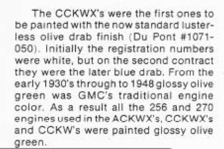

I've been told that Bruce Sunderlin is THE CCKW GOD. His multipart CCKW article in the MVPA rag is not to be questioned. EVAR! I have had Gilmore and Gopan tell me that on this and other forums.
Well, part III of the 'Sunderlin Articles', Army Motors issue #49 page 16:
I am personally asking Gilmore and Gopan and 'splain this. Gopan is currently on a 'nothing Tm9 Ord paint can do is wrong' kick. And Gilmore has admonished me for questioning the wisdom of Sunderlin, as have others.
Well, your god (Sunderlin) has spoken. Its just a coincidence that I happen to agree with him.
Anyone care to rebut?

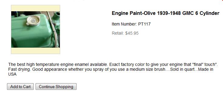

Re: ENGINE PAINT... SOLVED!!!
THIS:
http://www.oldchevytrucks.com/cart/prod ... 17&i=10521|||
Is the same stuff that I used.

The paint available from online restoration shops billed as: Engine Paint-Olive 1939-1948 GMC 6 Cylinder IS THE CORRECT COLOR.

I guess what I'm confused by is the very first sentence of the scan you posted:
"The CCKWX's were the first ones to be painted with the now standard LUSTERLESS OLIVE DRAB finish (Du Pont #1071-050)." Emphasis added by me...
How did this relate to the use of the glossy olive paint that is mentioned by you and also later in the same paragraph?? Or are they simply referring to the truck and NOT the engine??
That is the body color. The demo truck was painted glossy green (as it was a civvy truck).
The dupont color was the 'early OD' paint used on vehicles. Not the engine color.

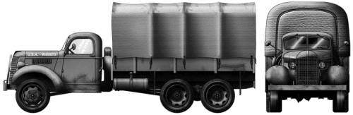

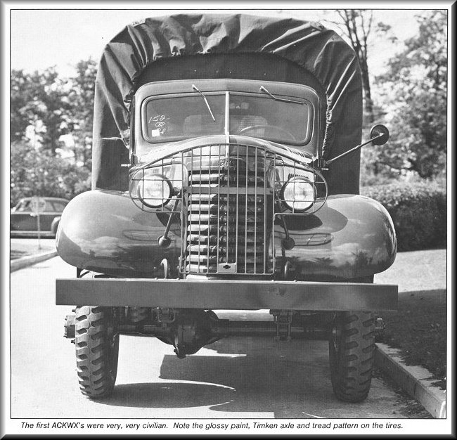

This is an ACKWX.
This is the photo used in the Sunderlin Article. Its the original image so its not dithered by the printing process. NOTE THE GLOSS ON THE FENDERS! You can tell it was a partly cloudy day!

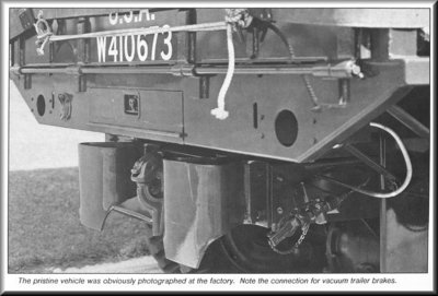

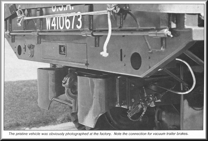

The ass end of the ACKWX. Note that its very similiar to the CCKW. The air lines were obviously deleted, the tool box cover is different.
But again, note the very civvy gloss on the bumpers.

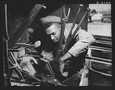

Pardon my french:
THE HOLY FUCKING GRAIL! LOOK AT THE BELLHOUSING!!! CHRIST ON A CRACKER THATS THE BEST PROOF EVAR!!!!

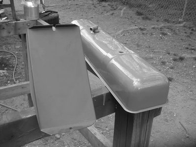

Now hear is my green paint:

Just to clarify about the photo of the soldier working on the cab of the CCKW.
'Negro Mechanic.jpg" was the name of the photo given to if by the NATIONAL ARCHIVES.
" This African American, then called Negro soldier, who served as truck driver and mechanic, at Fort Knox, Kentucky, played an important part in keeping the army's transport fleets in service. Photo was taken in June of 1942.
Photo Courtesy of Library of Congress Prints & Photographs Division Washington, DC
Photographer: Alfred T. Palmer
Control #oem2002004711/PP"
The link to that and many more photos:
http://www.archives.gov/research/africa ... -pictures/
Also if you google the first photo to come up is that one.
Just wanting to clarify the naming of the photo.

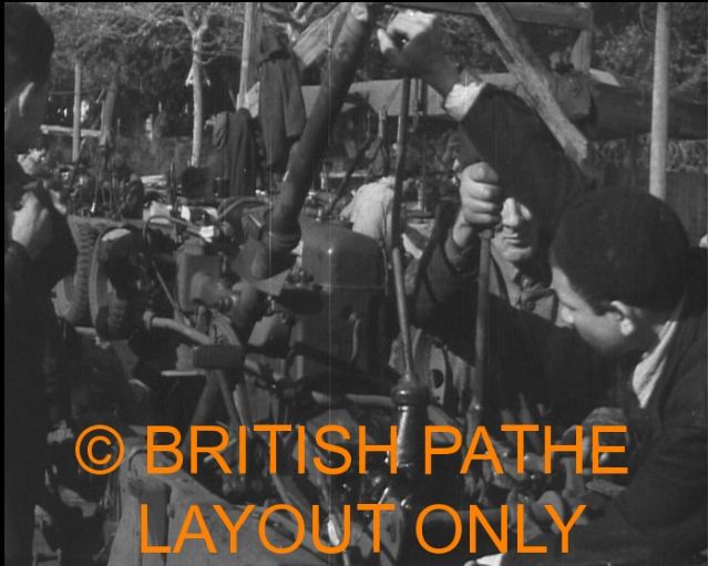

A link to this video was posted on http://www.hmvf.co.uk
http://www.britishpathe.com/video/army- ... +engineers
The clip is only 3 minutes (out of a 90 minute collection) but look at this:
Two things of note:
The obvious gloss on the valve cover
The valve tappet and octane decals are visible at the rear of the valve cover (partially hidden by the steering column).
The clip, even if only 2 minutes long, is a treasure trove of CCKW history.
Many thanks to 'Vulture' on HMVF (not sure if he's on this forums, but if so double thanks!) for finding this!

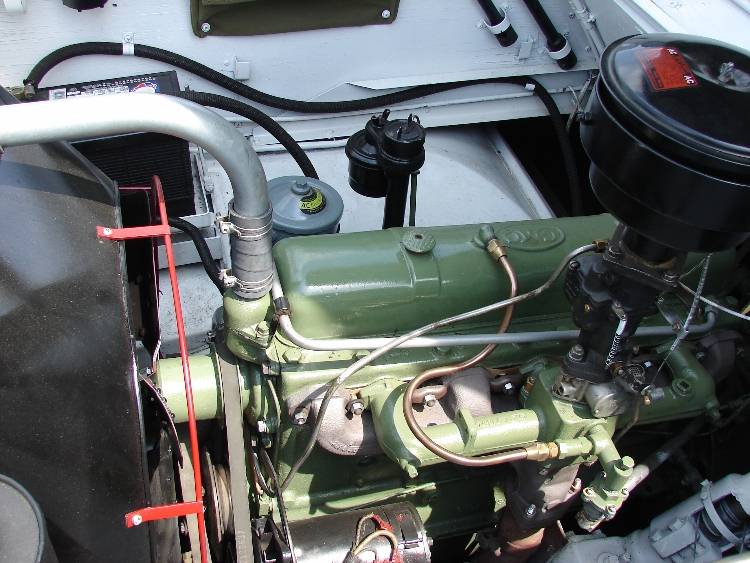

Here's an older pic (2007) from:
http://www.cckw.org/forum/viewtopic.php?t=2515
Other than the wrong oil lid decal (S2 oil filters were civvy only) and the air cleaner (thats a common decal attributed to Chevy air cleaners) it looks like what I have found out. Also most CCKW photos show later (late 42 and on) oil filler tubes as painted the olive color, not black. DUWKs are supposed to have the same engine as CCKWs... and a quick glance in TM9-1802A will bear that out.
If anyone can ID the owner tell them there is a free set of oil filter decals waiting for him.

Hi Paul
Happy to help out in assisting with another small piece of the jigsaw regarding the engine colour. I just need the nearest equivalent in a RAL code now, and I'll repaint my engine :)
