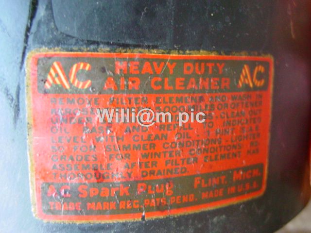

I was sent these images of an AC air cleaner decal. They are off an early jeep 'pancake' air filter:
I do not think these are proper for a GMC though. Although these are NOS parts, I must refer to a GMC TM10-1563 pageO3-2
It shows an air cleaner cover with the decal. Thats the best TM photo there is.
You cannot tell color from the photo :(

There are really only two items that need to be addressed. The 'hatching' in the 'AC' and the colors. The text could be figured out at some point.
First, no other AC decal for the CCKW has that hatching. While you do see it in other civvy decals for say, the S and L series oil filters, we pretty much have conclusive proof that the hatching never made it onto military AC logos FOR OIL FILTERS or the oil air breather. Well, with the caveat that we really don't know what was on the first CCWs from the 1940-1941 time frame (they originally had the dual oil filter setup).
Also the colors. I think that the oil filter colors are right, and it would seem that other AC air filter decals also kept that 'orange/red and black' scheme. The decals I have on this site are red and CLEAR. SO when you put them on a black oil filter lid they become (magically!) red and black.

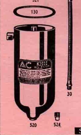

If you look in the sae manual from TM-WW2 (the SNL G506 - '44), there is another photo that clearly shows the "other" type of decal on the fuel filter. This could also have been in the maintenance manual that I bought from TM-WW2 at the same time. I'll try to find the pic I'm referring to, and post a pic. The same manual(s) show both type of oil filter decals (early round, and late oval). I have yet to find a pic of an air filter with a decal. I've found decals on:

I know what you are talking about.. and I did see the early round and then the later oval one. Neither appear to have the lines.
That follows the CCKW decals.. except that ACKWs had the dual filters with square decals... but other than that the round->oval progression seems the same.

Take the pancake filter (first photo) thick lines in an 'V' like pattern.

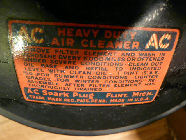

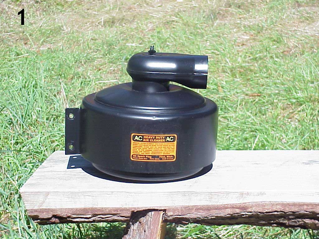

Was recently sent these pics of an air cleaner for a "Chevrolet military vehicle from 1941, 1942, 1943, 1944 and 1945". The hatching is very apparent. Waiting for more details from the tag on the box, to see if we can determine packing date, and actual application.
Air Cleaner
Air Cleaner
Decal
Decal

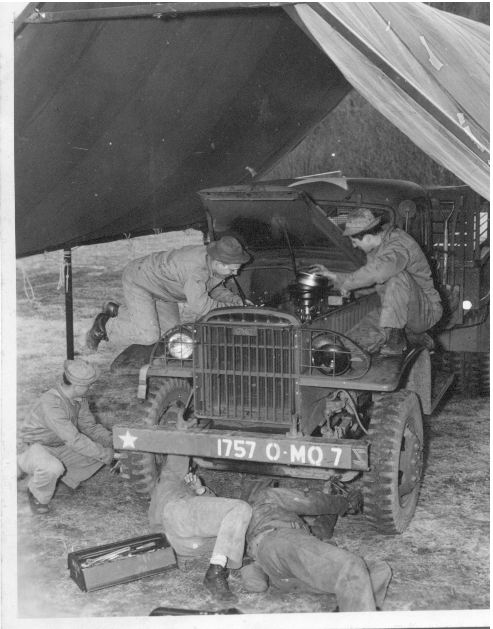

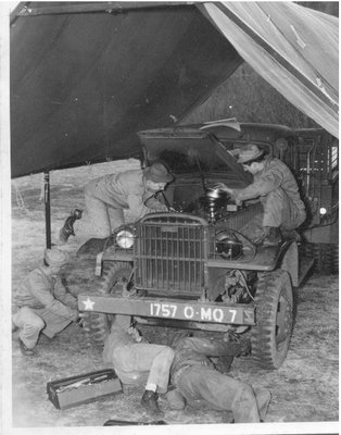

Here is the latest I have found:
The deal appears to be not white. I would guess orange. At least there is *something* that shows a decal on an actual truck.

If you blow up the black and white photo you posted with the air cleaner lid lying next to the headlight guard, it appears to have a very light area in the upper left corner, visible just above the bottom horizontal wire, which would correspond with the white, or perhaps white and orange striped decal as in the photo I posted. Another thing to note in the photo I posted, is the internal black area appears to be printed black, and not just transparent. Compare the interior black areas with the black outer edge, which could be presumed to be a clear edge??
