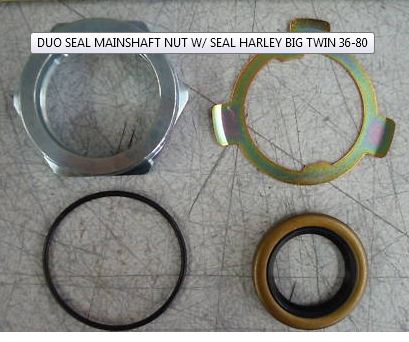

I think I have it figured out. After some ebay searches it seems that this nut/seal setup is still very common in motorcycles.
The seal is just that... originaly they were leather, but you can find straight up neoprene seals to snap into the lock nut.
All the lock nuts/spiders on my rear axles are beat to hell (used a screwdriver rather than a hub nut remover) so I plan to replace them all.
But I'm going to measure the spindle and nut and see if I can't get a replacement seal only.

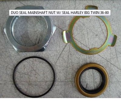

This is off a harley but I think the premiss is the same....
Evidently ebay was chock full of them 2-3 years ago.

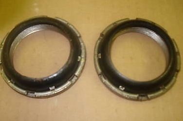

The Dorman nuts as pictured MIGHT work for the inner bearing nut (depends on thickness??), but not for the outer nut/seal assy, as there is no place to seat the seal.

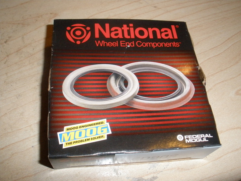

I received two (2) nut/seal ass'y from Ross Prince. they were spendy, but he had them while no one else I contacted had any. They looked pretty dry and crusty when I unwrapped them, and the seals were hard as rock. My initial thought was to soak them in brake fluid to try and soften them up... Fortunately I noticed on closer examination that they are not rubber and or neoprene. They are leather, and even have spring "fingers" inside to help them maintain their shape. Nixed the brake fluid idea, and have them bathing in a tub of motor oil. That should soften em up!

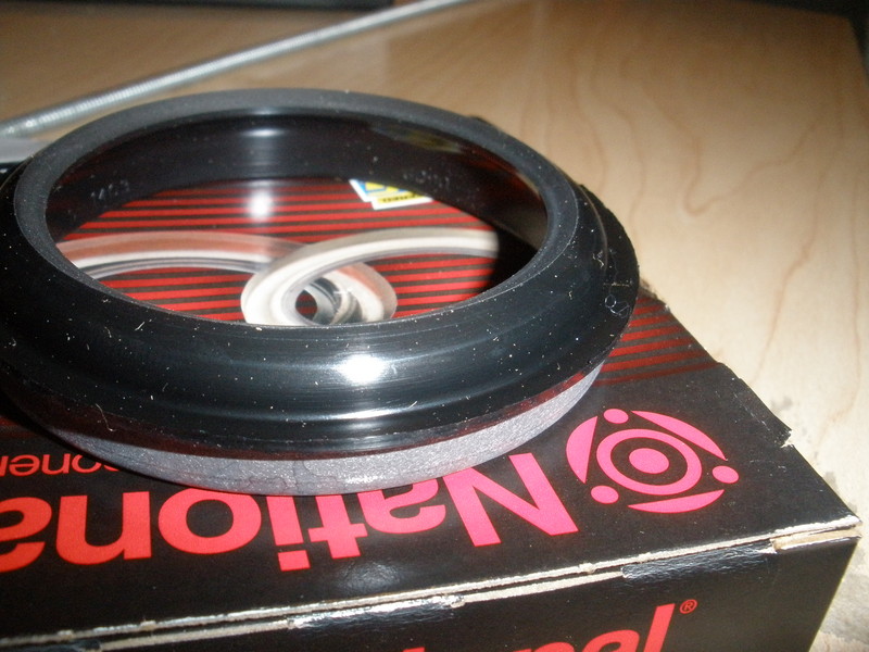

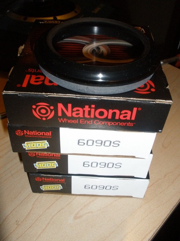

IF you have the nut part, but a bad seal, the replacement for the seal portion ONLY is National 6090S, which is also available(same part number) from other mfg as well. The best deal I've found is Autozone, for a Timken 6090S. It's a special order part, but they offer free delivery to their store.
http://www.autozone.com/autozone/parts/ ... ier=487292
Re: Spindle nut with oil seal cryptic post....
Paid a little over $22 dollars per seal, delivered.
Advanced Auto Parts SUCKS. Charged me $6 to ship it to THEIR STORE! I though it was coming to my house.
The are a little different from the leather seals currently in the nuts.
Since I'll have a few extra nuts to repair I'll post photos as I replace the seals in the older nuts.

pfarber wrote:P
Oh PLEASE! I told you what I had to pay for the two nut seals I ordered, because I don't even have the nuts... :P
Let me know how the replacement process goes for you.
