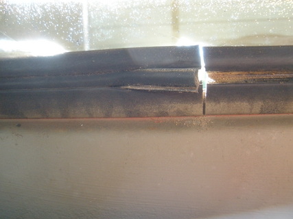

I did snap a pic of the rubber molding:
SInce the TM9 is mute on glass, is this the right stuff?? I figure its the same molding as on the civvy trucks?

It looks like you have the later style, which is just like the civilian type. It has a rubber keyway strip that locks the glass into the rubber channel. (At least I think that's what I'm seeing on the left side if your pic. There is a special tool for inserting that strip. You can buy it from Jim Carter, and get a partial refund when you return the tool.
Re: Side a rear windows... uh oh.
Yeah, there was a center piece that held the glass in place. The rubber was dry rotted and I pried out a big chunk by mistake.
Is the tool absolutely required? I'd thinking a dowel and some soap should work to get the locking bead in place.

pfarber wrote:Is the tool absolutely required? I'd thinking a dowel and some soap should work to get the locking bead in place.
Don't know. I suppose there's a dozen different ways to skin a cat. I just know that somebody thought the job needed a special tool... Let me know how the dowel and soap works out! :shock:
