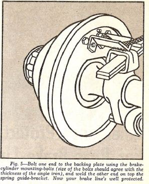

Its called:
Kit, front brake-hose protector G501-5700571 MWO ORD G508-W10
This is a line drawing of it.
Would be cool to see an original.
Re: Anyone have the front brake line protector kit installed
I presume this is the front TANDEM axle, and not the front steering axle??

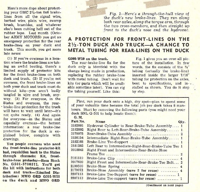

The image is for an 'emergency' rear brake line protector... but the November article mentions a front brake line protector. I've read the AMs twice and its using front, front-rear, rear-rear descriptions.
If you have the October and November issues of Army Motors pages 194 and 231
I read this to mean that there is an emergency REAR brake line mod (the angle iron, October AM), a NEW MWO KIT for front (steer axle) brake line protectors for the DUCK/Truck and the November issue of AM details how to convert the Duck/Truck REAR axles as a FIELD MOD. The front brake line kit is never shown, only referenced

I can see how the first post is a bit confusing... it does show the front-rear axle, not the steer axle.
But this is the last paragraph from the October AM:
So there IS a specific front brake line kit.
