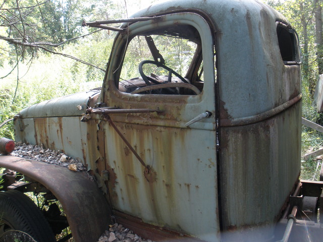

Its a rust bucket.. its has a good frame and driveline.. and I will try and get the most out of it as I can. But most of it will be cut to less than 5ft sections and scrapped. To see if I could ever make the mythical amounts people claim to.

Trash in cab bed were aftermarket seats, and there was some general garbage in the bed. There also is a halftrack tire in the bed, its rusted beyond use, so I will cut out the rim and throw the tire away.
Two other rims are also shot (rusted) and will have the same thing done to them.

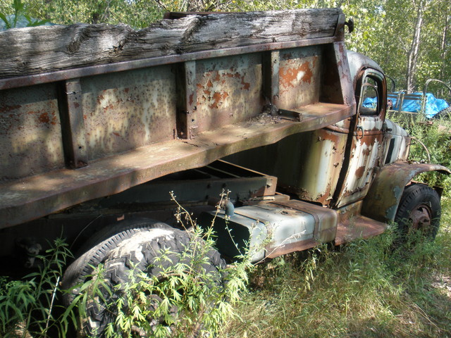

The dump bed is much thicker than a steel bed, so I don't believe that a standard cargo bed would bring in ~$150. The big money is in going to be in the sub frame and dump cylinder... that's IF the scrapper gives me #1 Steel prices.

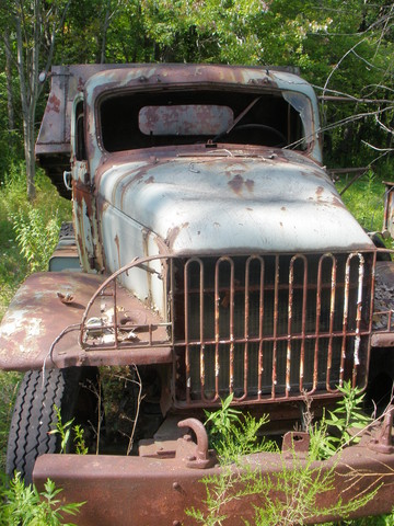

I don't have a parts list... but there are two trucks, with most of the commonly needed items gone (fuel tanks, tire carriers, bumperetts, original engines, seats, etc).
One runs and drives, but vac is shot. The other is nothing more than a frame and driveline... poor sheet metal.
