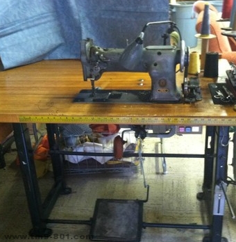

New toy Singer 111W155
Posted: Sun Jul 07, 2013 2:37 pm
Got this off ebay for $250 (table, head, motor) and it works perfectly. Got a few projects done and this thing sews like a boss. Still trying to slow it down (I really don't need to sew 3000spm.. I'd be happy with 1000 :) )
Great deal. Guy was 93 and was finally selling off some machines so he could retire... AT 93!!!!

So, evidently I did have a timing issue that went unnoticed until I tried to repair a fairly long seam. The hook was slightly out of time. Referring to the NAVTRA's they had a section on how to time, but in traditional Military TM'ese it was one thing to read it, another thing to make the machine do what the text said. The answer is in the illustrations in NAVTRA 14217 and 14218. Make the machine look like the figure... DONE!
Another issue that I discovered in the long seam repair was that the thread controller disc and spring were backwards. Had to flip them. So far at 30 inch seams its all running good. So I'm gonna hold off on the $93/hr repair service till I really have trouble.
On other lesson learned... the parts I got from the local 'Authorized Singer Repair' place were garbage. Original Singer parts are milled from steel and given a black oxide finish. The crap I got was cast and chrome plated. Needless to say whatever child in the Chinese factory that made those pieces of garbage was having an off day. The vibrating presser foot didn't fit the original Singer shaft, and the walking foot had toes that were not parallel... and both were SLATHERED in some shitty chrome like plating. The walking foot's needle hole was an oval shape... at one point it probably was a circle, but the finish they slathered on it clogged part of it. Found a place with actual Singer parts... twice as expensive but if the parts don't fit they could be free and not worth the trouble.
