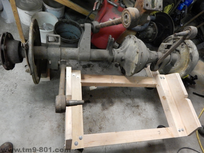

Somehow I have amassed more axles than I know what to do with. And no matter where you put an 8ft long 700lb+ plus axles they always seem to get in the way. So I made a trolley to move them around.
Here's the trolley with a split axle:
Top view:
Its a very simple design, 4x4x6s mainly and a 10x12x2 with some casters from Harbor freight. Total cost is about $70 to make. The casters are 330lbs each so they will handle well over 1/2ton (HF item #69852).
The length is 42 inches and that allows the supports (10x12) to fit next to the spring seats:
The support is notched otherwise the axle will roll off:

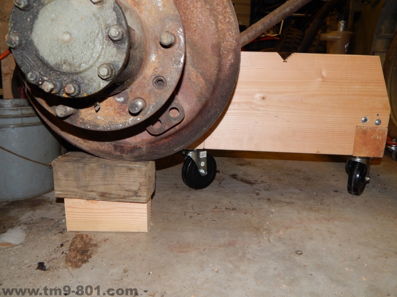

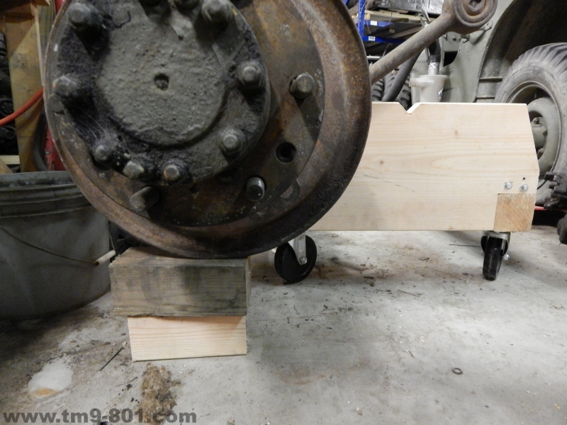

Getting the axle onto the trolley was an adventure. My gantry crane could not reach it, so I had to use floor jacks.
Using the old 'jack up one side at a time trick' I was able to use the scrap 4x4 cut into 10 in segments to raise the axle up:
With the trolley next to the axle it was easy to lift on end and slide it over:
The design of the trolley (42 inches from end to end) will fix BOTH split and banjo axles. Plus, just by dumb luck, the height of the axle is just right to sit on the floor and work on the bearings.
