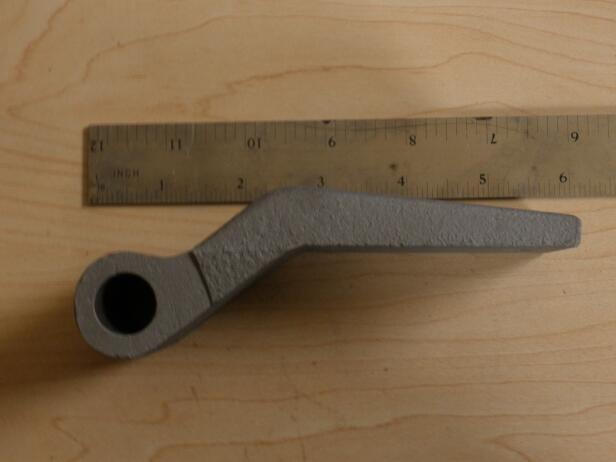

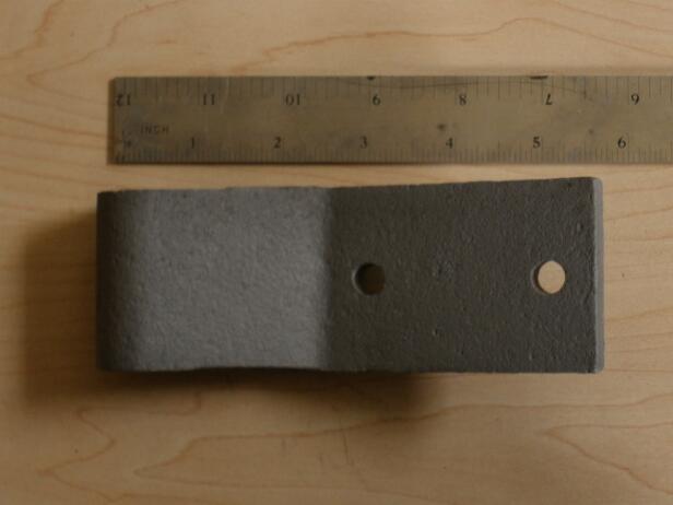

First part has been mastered. The lower hinge. Pics are below.
The tan stuff in the original casting is putty because the mold will not release if the casting material in in them.
