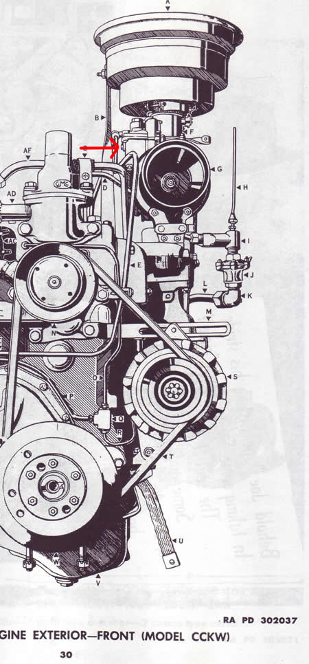

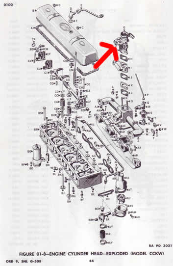

More images of the fuel bowl plug. These are from the JULY 1945 version of the SNL. This is one month before the war ended and all CCKW production was canceled.
In the engine ID section we have the plug clearly visible. If its not that important a part, why take the time to draw it?
Here it is again. This is 1940s tech. These drawings were hand drawn, they simply didn't click the 'rotate 90 degrees' button on their CAD computer and get new view.... it was hand drawn in.
This drawing is EXTREMELY interesting because it does not deal with the carb AT ALL. Its an exploded engine diagram.. yet they STILL drawn in a sight plug.
So the next time someone tries to explain that the CCKW carbs didn't have sight plugs on them ask them what proof do THEY HAVE? I bet you get excuses, conjecture, stories about their military training.. everything but PROOF.

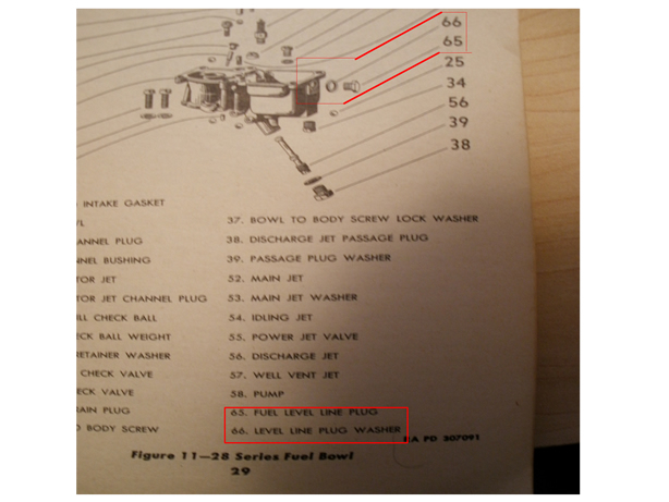

Here's a tid bit from Zenith Series 28 and 228 Operation and Service Bulletin Z-190-B dated August 1950.. this Bulletin supersedes the December 1948 Z-190-A .
The illustrations are pretty much identical to the ones in the TM9's. The parts breakdown are identical to the SNL for the die cast.
While the parts diagram does call out a fuel level plug and washer (65, 66) nothing else is mentioned about them.
A good thing about the Bulletin is that it does list the tools requires and information on reaming cast iron base for bushing the throttle shaft.

You are correct. Initially I believed that the sight plug was always there.
I never knew of the parts manual you mention, till you mentioned it. The TM10 series was based on CONTRACTS, so new TM10s didn't make earlier TM10s obsolete like the later SNLs and TM9s did.
The Zenith model 30 is the CAST IRON CARB. The PN is 2137474 (double check your PN... are you missing a '4' at the end - 213747 ??) I just scanned in the TM9-1826C to post later this week.
The Model 30 went onto CCKWs in Feb 1944. This was a pure Military design, whereas the 28AV11 was an off the shelf civvy product.
But since I acquire more and more TMs/AMs/SNLs etc it seems that there was a short period (maybe 10-15% of production, 41 till mid/late 42) that had a 28AV11 without a fuel level sight plug.
SNL-G-508 p108 does list these:
GM-2143816Z-A3-52Bowl, Fuel, Carburetor Assembly, Superseded by BOWL GM-2198543
GM-2198543Z-A3-52FBowl, Fuel, Carburetor Assembly
Gotta wonder what the 'F' stands for... and when it was put into production!
But I gotta give a LOT of weight to the evidence that is pointing to a mid/late 42 appearance of the sight level plug.
