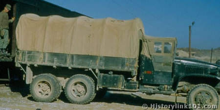

JACKPOT!!!!

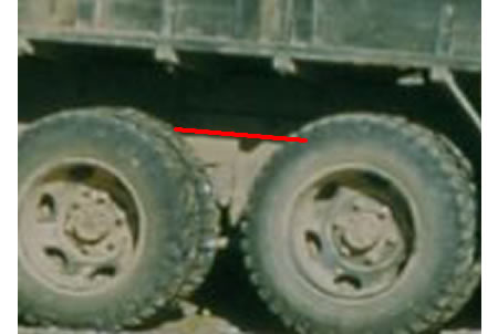

Lookie here. A late production CCKW 353 with the cut out for the rivets on the bed sill.
Lets blow that sucker up and look closer shall we???
Well well well... looks like a taper in the sill to allow for the cross member rivets above the rear bogey. MY MY MY.
Let me sum this up with a 'SUCK IT' to all the people who say that the beds are counter sunk to allow for the rivets only.
All you gotta do is LOOK and not blindly follow.
