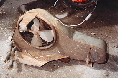

There are few options for getting heat into a CCKW. One option is a 'Harrison Heater'. BUT most of the heaters are not NOS, nor are they WWII era production.
Take this image of a Harrison heater installed in an unnamed CCKW:
Note the boss (or hump) on the far right side, at the point where rounded metal transitions into the flat portion (near the 'point' of the triangle).

There only thing I want to confirm is that raised boss from the second photo. I've read that its supposed to be for a lever that controls an adjustable baffle. But I could not confirm it from what I could find.

I have a copy of the manual you mention (YT-4336). The only photo in the manual which actually shows the front of the heater does NOT appear to have the small circular boss visible in the pics above. I have a take-off heater, which has all of the characteristics of a CCKW heater (straight heater core pipes, short back mounting plates, etc.) and signs of OD paint under the existing top coat; but does have the raised boss. It is also put together with clutch head screws, like the ones used in my Chevy truck cab. Maybe the boss is a later issue feature??

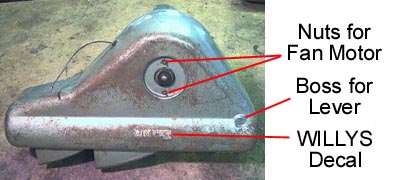

You mean something like this one??

Wow you're good. It looks like that's the reason for the boss.
