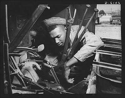

Posted: Mon May 14, 2012 1:33 pm
Pardon my french:
THE HOLY FUCKING GRAIL! LOOK AT THE BELLHOUSING!!! CHRIST ON A CRACKER THATS THE BEST PROOF EVAR!!!!
Negro mechanic.jpg (32.21 KiB) Viewed 109336 times

Just to clarify about the photo of the soldier working on the cab of the CCKW.
'Negro Mechanic.jpg" was the name of the photo given to if by the NATIONAL ARCHIVES.
" This African American, then called Negro soldier, who served as truck driver and mechanic, at Fort Knox, Kentucky, played an important part in keeping the army's transport fleets in service. Photo was taken in June of 1942.
Photo Courtesy of Library of Congress Prints & Photographs Division Washington, DC
Photographer: Alfred T. Palmer
Control #oem2002004711/PP"
The link to that and many more photos:
http://www.archives.gov/research/africa ... -pictures/
Also if you google the first photo to come up is that one.
Just wanting to clarify the naming of the photo.
