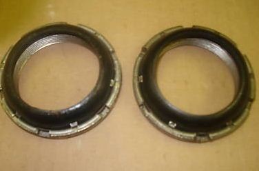

I received two (2) nut/seal ass'y from Ross Prince. they were spendy, but he had them while no one else I contacted had any. They looked pretty dry and crusty when I unwrapped them, and the seals were hard as rock. My initial thought was to soak them in brake fluid to try and soften them up... Fortunately I noticed on closer examination that they are not rubber and or neoprene. They are leather, and even have spring "fingers" inside to help them maintain their shape. Nixed the brake fluid idea, and have them bathing in a tub of motor oil. That should soften em up!
IF you have the nut part, but a bad seal, the replacement for the seal portion ONLY is National 6090S, which is also available(same part number) from other mfg as well. The best deal I've found is Autozone, for a Timken 6090S. It's a special order part, but they offer free delivery to their store.

Paid a little over $22 dollars per seal, delivered.
Advanced Auto Parts SUCKS. Charged me $6 to ship it to THEIR STORE! I though it was coming to my house.
The are a little different from the leather seals currently in the nuts.
Since I'll have a few extra nuts to repair I'll post photos as I replace the seals in the older nuts.
